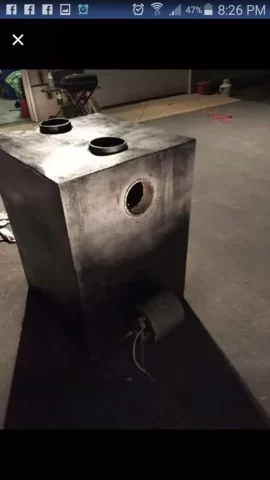

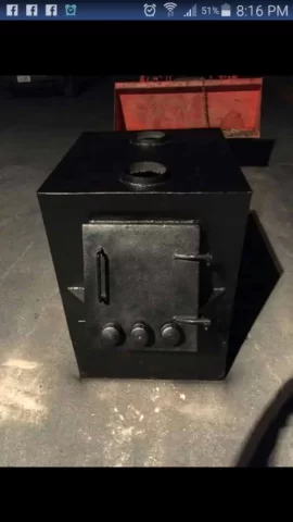

I just bought this stove and going to install it. the person I bought it from said I could use it inside. any thoughts on this stove would be appreciated looks to have been made by someone.
[Hearth.com] What kind of wood stove is this? [Hearth.com] What kind of wood stove is this? [Hearth.com] What kind of wood stove is this?
Bought this wood stove to heat my 1300 square foot house. Only source of heat I have. Could anyone tell me what type of stove this was built to be like? This stove was within my budget and was told it would do the job. New to burning wood. Grew up around stoves when I was a kid other than throwing wood in I know nothing else about them. Any help wood be greatly appreciated.
Unless there is a tag or label on it, it appears to be locally or home made. It's also a furnace so not sure how it will work in ducted . where will it sit? They were designed to sit on a concrete floor. Not sure how you will determine hearth requirements and be safe. One of the flues is the chimney and the other is piped into the ductwork. If you have a basement and duct work I would put it there?

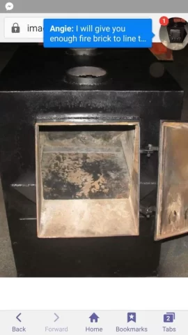

The dimensions of the inside of the stove are 30"deep x 22 1/2"wide x 19" high but only 14" high at the back there is a piece of steel under the outlet that sticks out 12" all the way across the back.

Why are there firebrick on their side inthere? That is just crazy
This will be the only source for heat there is no electric furnace in the house it was took out. They put in a heat pump that runs off of propane which the tank is out of date. I moved in here last January and only used space heaters to heat with and it didn't get very warm still had to have warm clothes on. The electric bill was outrageous. So trying to get ready for the cold this year. We live in NC around pilot mountain area it doesn't get below zero here but usually in the low 20s.
It doesn't have a great in it use to but the last owner took it out. it has a ash pan so I put the firebrick on its side to get up to where the great use to be. So I'll be shoveling the ashes out.

Looks stout and homemade. No legs which means it would need to be setup on a totally non-combustible platform (maybe made out of cement blocks) or used on a cement slab floor. Clearances for unlisted stoves are 36" in all directions to any and all combustibles.
