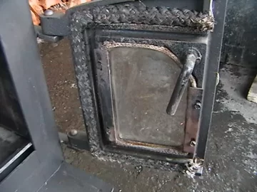

What model is this and how hard would it be to find replacement glass?

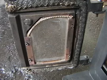

[Hearth.com] What model is this and how hard would it be to find replacement glass? [Hearth.com] What model is this and how hard would it be to find replacement glass? The glass is not difficult to replace. It sets against flat gasket material wrapped around glass edge, and is held in place with a piece of flat iron. Do not over tighten so glass can expand.

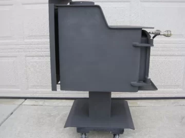

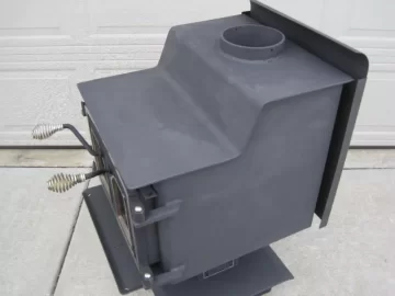

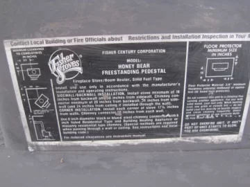

The one pictured has the pedestal welded to the stove bottom and air intake sliders above and below doors. This is NOT the mobile home certified version called "Convertible" that the manual is for that is uploaded on the manual thread. Convertible has a removable pedestal. Pictured is a regular Honey Bear. It should have a UL tag with clearances on the pedestal as well. I believe clearances are the same. I will check. The tag is very small and needs to be read with a magnifying glass, or I can get a pic of one. Not easy to get at right now, behind the stove where I have them displayed. Not sure if this is readable on what you are viewing with;
Stove dimensions are given on page 3, they are the same as Convertible model.

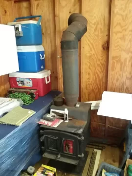

Be aware your picture does not show the rear shield that must be installed for UL compliance and reduced clearances given. The increased connector pipe shown (8 inch) is also against code since the stove requires 6 inch connector pipe and chimney. It will not draft properly or clean glass with air wash properly as pictured. That large pipe creates a condenser that allows flue gasses to expand and cool, allowing water vapor in exhaust to condense on pipe walls. It also looks like it is installed upside down with male up which allows condensate to leak out onto stove. It may even be galvanized?? Can't tell in the picture, which is toxic when heated. Stove pipe will be heavier gauge than heat duct pipe that it could be, including the increaser / reducer.That little Honey Bear can no way heat that large of a flue area and have enough heat left to radiate to the area it is capable of heating.
Rear shield mounts on 4 studs welded to stove rear with nuts to hold in place. CamFan also has new old stock blowers that mount on the bottom, they are variable speed and move air out the top forward of the stove.

Thank yall for the Info. Coaly I did notice that shield missing. I'm going to try not to offend this guy but I am going to make him an offer on it then try to find the parts. I may or may not use it. I've got several fishers already.....i just have this fisher stove addiction that I cant seem to kick. Haha. Thanks fellas.
Coaly is the ul label on the heat sheild or the stove body.
If it was on the heat sheild and that is missing it is no longer a listed stove and that really drops the value. If the ul tag is gone I think it is worth $200 at the most
