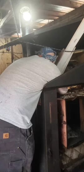

For what it's worth...
I have an Econoburn.The flue tubes are cleaned the same as the polar boiler.Just cleaned mine on Sunday.
I have a tool i made that takes the hard buildup off the tubes down to shiny metal.I noticed an immediate difference in the next load.It takes 20min per tube when its dirty.Mine has 6.Removing the top cover and removing the turbulators takes about 10 minutes same as reinstalling them.So to clean mine totally takes a couple hours by the time you clean up after you are done.
Econoburn's newer boilers should be getting close to having EPA certification.Their new units got delayed due to covid,and couldn't get tested.
Mine is on it's 14th season,have replace the nozzle twice.
I have modified the turbulators which has dropped my stack temps.The boiler was designed for hard wood.All i have access to in the Yukon is spruce and aspen.I believe the spruce wood off gasses quicker than hardwoods and was the main issue of high stack temps.Although prior to the turbulator modifications i had brought the stack temps down by making my splits bigger.
5-7 years ago i would have bought another no questions asked.
When it comes time to replace this one, hopefully get anouther 14 years out of it, i will be shopping around as there has been big steps taken to produce a better boiler by a few manufactures.
