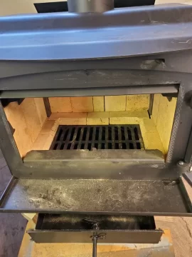

If you have a sealed ash drawer and a nice big grate, then its likely you will use it...but for the stoves that don't have a sealed pan area, they have a sealed plug that has to be dug out of the ashes, then ashes chased into the little hole (fiddly operation) then the hole cleaned up enough to get the plug back in and sealed. Real PITA! Much easier to just carefully shovel them out and be done with it! I used my ash plug and pan exactly once.
Oh, and if their were some live coals in the ashes you just put in the pan, since its not sealed, there could be a CO2 risk...not idea how they get away with this design!
LOL That's exactly what I figured and why I did this before I even installed it. My basement wood stove is set up with a full grate and slots that allow the ash to stay in place while still hot. Then the backless drawer/shovel is easy peasy dump in the can.
In red....totally agree.

I like my pan. I keep a good layer in the stove too. I just push the ash away from the doghouse to clear a path for the air inlets. Push it away from the front of the stove and stir a bit down the grate each load.
I can open ashpan door, pull the tray and have it closed again in 3 seconds. Repeat process is the same. This means I really don’t have to let the stove get too cool before emptying ash.
I will say a makes a real mess to over fill the ashpan The mound on the top gets scraped off and ends up on the bottom of the housing and then get shoved to the back when you put the pan in. Do it more than once and you might not get the door closed all the way causing a leak and or overfire. At the end of the not a feature I would use in making a purchasing decision.
In RED.....The hot set up is to not have the back side on the ash drawer so its like a shovel. Then you don't pack in the overload just socop it the next time in.
