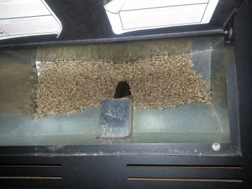

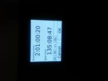

These are some pictures of the run time on 12 volt. Stove was cleaned and started, hopper was filled and we left for 2 days. The upper number is the run time, 2 days 1 hour 0 min 20 sec.

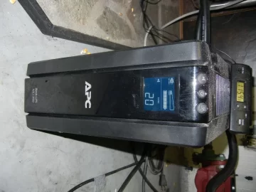

I got a nice UPS and it indicated 19 power incidents in one month.
So your UPS indicates if there have been power incidents? Did not know that they did that. Would that be listed under specs?? What UPS do you have??

We are away right now so I will have to get back to you on the amp hours. Right now the stove is running with 3 batteries wired in parallel, with the charger plugged in and maintaining them. If for some reason power drops out, the stove will carry on for the next 60 to 80 hours. I feel confident in saying this; as the stove only draws .06 amps in position 3 of the heating cycle, it does not stay up there very long before it drops back to 1. While we are away I will run it in position 1 to retain maximum heating time which works out to about 47 to 50 hours before depleting the hopper. Please see photos in post above. Something that started out as only a test, has now turned into a 4-week adventure running on battery power and will protect the stove from any future power spikes by staying off the grid. I am now thinking of building a hopper extension to add at least another 30-50 hour total burn time (trying to push into 100 hours without refilling).
Thanks to the Paromax ash-management system, this affords us the opportunity to leave and go away for a couple of nights and know the stove should still be running. This is how a $3000 + stove I believe should perform.

Old countryside on corn with hopper extension 3+ day and now with a Harman with extension. The UPS keeps the power events from being a problem. Rare to have power out in winter here, just hiccups. Summer is another story, so 12 vlt backup for sump pump.
Thanks for the pic of the UPS
