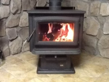

We have two Pacific Energy Super 27s. Both are about seven years old. I like the ash pan since I made more dirt when I attempted to shovel ash. Some hate the ash pan because air can leak through the trap door. I always make sure that the trap door is closed securely and I leave ash in it when I clean out the stove.
The only repairs that I have made are replacing the door gaskets (DYI with kit from Amazon) and paint. The stainless steel baffle is very durable.
