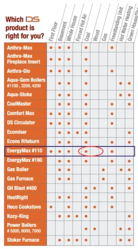

The Energymax is advertised as both wood and coal,
If you go to their website it is listed as exclusively for coal. It will not be an efficient woodburner.
