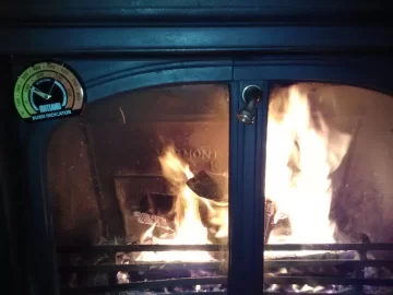

btw, just closed mine 95 percent after 2 hrs 15 min and temp 400 degrees
***this pic taken 1 15 hrs in and waiting for some heat!

Third person on LI that said stove's been funny last couple days (includes me) ;lol . I start shutting down around around 400 stove top but that is not a hard and fast rule. Depends on what the fire is doing. I'm into the color, don't like sooty orange. Sooty orange = more air for me. I don't like your thermo placement door temps are not accurate. Can you get it on the top somewhere? In the vent maybe. Mine is in the vent and I need a flashlight to read it but it's accurate in that position.

Hey Neighbor-- in Suffolk here- you? where in the vent r u referring? do you have a pic? got this gauge today at Home Depot-- wasn't sure of best placement though

Holbrook area......... yeah I guess I could put it there---but thats the output temp-- right? i thought we should adjust by INTERNAL insert temp..am i wrong?

That should be your top temp which is usually the best you can do especially with an insert since you can't check stack temps. After awhile you get to know when "my thermo reads this the fires doing this" if you know what I mean.
Not a lot of wood in that firebox. Also, measuring temps in an insert is different than on a free standing stove.
Combine the two and there's your problem.

How, exactly, are you measuring internal temps?

Yes I agree---- That was a burned down initial fire i started just before i added :).....where would you put it BB , you can see my insert pic, i assume. Thanks!
You can put the thermometer anywhere, you just need to be aware of how that spot reflects the temperature of your stove as a whole. You need to find out what is the recommended spot to measure temps and what temps are recommended for that stove. I have no experience with this stove.

+1 on the small amount of wood; have you tried loading that thing right up? Don't know where to get a good temp reading, but, load that thing up get the wood going well and charred then start closing the air control by 1/4 increments waiting maybe 10 between and watch your secondary burn. With a free standing EPA stove, the air is pretty close to right when the fire is on the secondary tubes and just dancing across the logs; if you star to loose it you closed too far, open up and restart you'll learn what to expect from your setup pretty quick.

Thanks--i but have an insert. its reco'd to not heat it up TOO fast or damage can result-- i don't know much-- novice here trying to learn from all my new friends here! thanks! HNY
So the pic is of one of your break in fires? Good man for following the manual! The second year burning gets so much easier. Then you are just fine tuning things for max efficiency.
