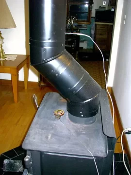

G'day all. I love this time of year when everyone starts to kick back into burning their stoves... love all the questions and discussions. Anyway, when I swapped out my old stove for the Drolet Austral I also decided to switch to telescoping double wall flue pipe for efficiency and ease of cleaning and whatnot. Although I've been running my stove on and off now since October, I just got around to putting a thermocouple (with a digital readout) into the stack, and now I realize that I'm not sure what sort of flue temps I should be expecting, especially on start up. Up until now I've been using a digital laser thermometer, and reading stove top temps to regulate when I start cutting down the air on the stove, and I've been very pleased with how the stove has been running using this method, but it would be nice to know how hot the flue is (and how hot it should be) as well.

Thanks Doug. I just fed the stove with a small load after posting this thread, and I'm finding that the stove top is running about 30 degrees hotter than the flue now that it's settled down to cruise mode. I should also mention that I put the thermocouple at about 4' above the stove top (to avoid tripping hazards with wires etc). It was interesting watch the flue temps while I was starting up the burn; I continued using stove top temps to guide me in shutting down the air (start shutting down air at 250 degrees).... The flue temps peaked out a bit over 650 before settling back down into cruise mode..... All looking good.... :-)

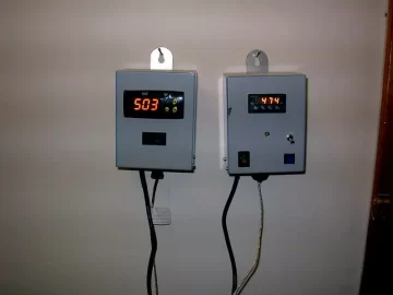

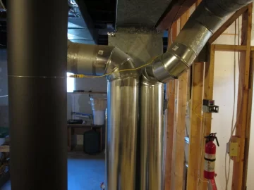

Hey Wes, are you the fella I remember that has the pulley system hooked up to automatically adjust the air control? Regardless, I think automatic air control is a very cool idea.... Pics are always nice to see though, hint hint.... :-) I have to say that I really like the digital readouts your using. The look nice and clean and professional, as in an insurance inspector would nod approvingly at your set up for sure, whereas he might start clucking his tongue looking at the old temp controller I'm using with open/visible connections. Over the last year or so I've been mightily tempted to buy the Auberins TC readout, but maybe I can just build a nice little box that I can mount this controller/readout into....
As far as the extreme height of the probe in the flue, well I just wanted to run everything high enough overhead so that I could walk comfortably underneath the thermocouple/electrical wires, thus avoiding tripping hazards. I really just wanted to confirm that using stove top temps was working well and that I wasn't generating way too high flue temps by operating the stove that way....
So when l loaded up the stove on a nice bed of coals last night for the overnighter, I turned the air down to about 25% open when the stove top reached 250 - 300F (I can't remember what the flue temp was at that time), and then spent the next 5 - 10 minutes tweaking the air down lower and lower by very tiny increments (very slow lazy flames, just above the point of extinction, is my goal when adjusting the air at this point); over that 10 minute period the flue got as high as 850F, while the stove top ranged from 690 - 725F, depending where I took the temp. Once the air was shut down and the stove was cruising to my satisfaction I signed off and bid my baby (my stove) sweet dreams.... :-) This morning at 6:30 the Ecofan was purring away while the flue was running about 220F and the stove top was around 190 - 200F with a nice bed of coals all ready to restart the next fire...

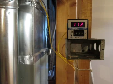

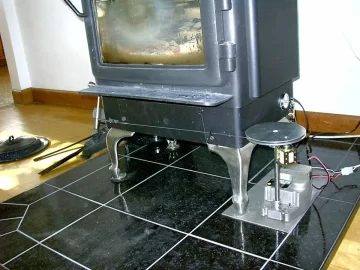

Here is a description of my setup I posted previously.
I have built an automatic air control. You need more than just a timer, mine has a probe in the flue and a digital timer( not shown in pic).
The way it works is when the flue temp reaches 875::Fthe damper motor is actuated, for about 3 sec, this will close the air about 1/4.
The timer waits for 20 sec, if the flue temp is still above 875::Fthe damper motor will be actuated again and close the air another 1/4.
Cycle will continue until flue is below 875::F.
The system works quite well, if you load on a hot coal bed you will get some overshoot, but the flue temp will usually be under 1000::F.
I recently made a video of my system in action, when I get a chance I will post it.
http://s1321.beta.photobucket.com/u...t=3&o=2&_suid=1360888990034044668913306779595
http://s1321.beta.photobucket.com/u...t=3&o=3&_suid=1360889680009022424730311166158
