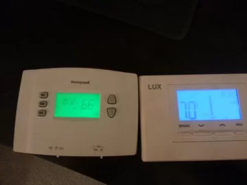

Had the honeywell for a couple years--- works great, but with no swing the stove was cycling too much. Time to upgrade to one with a swing. Bought a Lux 1500 with swing on a reco fro the board here in a few sigs/etc. Seemed to be a good unit for the money.
Well, i'm completely unimpressed with this thing.....
Here they are side by side sitting on the coffee table for about 1 hr with no one touching them or being near them. It got down to 61 deg in the room before the thing read 68 and fired on the stove.
The honey well matches the oil big thermo on the wall FYI, and i assure you it was 61 because it was COLD in here.
"Factory calibrated" my a$$.

After nearly 2 days of laying side by side (and my stove on manual mode), the lux has come down a bit, but it still reads about 1-2 degrees higher than the honeywell.

My Lux plug in thermostats have an adjustable offset that allows you to sync it with other thermos.

Page 25 tells you how to match temperature readings between thermostats.
