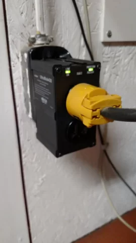

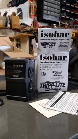

Yeah, I just put one of those in today. From what I've read, they're one of the better ones.
