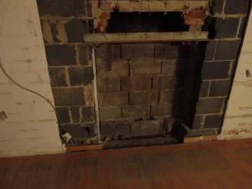

I'm in the process of rebuilding my fireplace and upon removing the old brick facade, I discovered an outlet next to the opening, where my stone will go.
I want to apply my stone directly to the existing brick, but the wire is in the way. I can eliminate the outlet, but that doesn't get the wire out of the way.
Anyone have any ideas?

Find where it originates and remove it from that circuit entirely. Then you can do what you wish with that end of the cable. I always mark a cable on both ends after removing it from a circuit to indicate that it is no longer part of any live circuit.
If the circuit remains live, the end terminations of that cable need to be accessible in a box per code.

Do you know where the circuit goes after this outlet? Is the next fixture in line expendable or important? If it's essential note that you can't bury a splice in the line. That splice needs to remain accessible which means keeping the outlet or at least a junction box with a blank cover.

I should have clarified what I meant. If you can follow where this cable comes from and disconnect it from there, then you're all set. For instance, if you follow it to the previous receptacle up the wall, you can un-wire the cable from that receptacle and be good. You would basically be removing this receptacle and the wire that feeds it from the rest of the circuit, and the rest of the circuit will work just fine without it.
It looks like the wire is a pass thru, with the circuit continuing on beyond it, but maybe I am mistaken. If not, it needs to be determined what else is downstream on this circuit.

Exactly and that's the cause of my apprehension of rerouting it.
I'll probably put up backer board and route it around it, I just figured maybe someone could come up with something that my feeble mind may have missed. Heck it's only 30 bucks to cover that area with board. It looks like the wire goes off to the left. I've got it pinned back, it goes straight up and exits from the brick.

But the thing is, it's part of a continuing circuit and if I remove it, something or things aren't going to work. Even though it disappears into a brick wall, I can figure out where it comes from and where it goes, but I can't take it out of the circuit, unless I'm still misunderstanding what you're saying.
Turn off the power to the circuit. Break the circuit by removing the receptacle, without cutting any wires or the wire-nutted splice in the box if there is one. Make sure hot wires are temporarily taped or wire-nutted to avoid shorts and shocks. Turn the circuit back on and find out what is not working.

Can you re-rout the line side into the crawl space or the attic and there, install a junction box and rewire in a safe place to the down-stream portion of the circuit? It looks like the line side come from the attic so the simplest thing would be to pull in up into the attic and install a junction box. Then, you can run from the junction box down through the wall in some other location away from fireplace, to the down stream part of the circuit, which probably can be connected to with another junction box in the crawl space.
shut it off then disconnect it and pull it back down into the space below like a crawl space or basement. then junction box it. while in the basement run a new wire up the inside of the wall about 6 inches to the left and run the wire coming from above in the wall and reattach to the new outlet. if i read right you have a garage that backs up to the fireplace. if the wire coming from above is to short to run into the wall poke it thru to the garage and box it out there then run a wire from that box to the basement where you already pull down the the wire from the fireplace

That's my fault sorry. The pic wasn't clear and I should have asked.

I'll take a look at that today. The house electrical panel is directly below and when I looked, I couldn't see a wire that went up to that area. I believe the lower wire goes through the brick, to an outlet on the other side of the wall (garage). If that's the case, I'll just cover the wire with stone and move on.

If the wire went directly down there, I could do that, but I don't think it does.
This one won't be. It wasn't accessible before the demolition, when it had a 1-1/2 ton brick wall in front of it.
Then it was an existing code violation. Here is your chance to correct it.

If you've ever had a splice ( wire nuts) loosen with temp, changes, vibration, etc. and they do go bad, hidden in the wall will drive someone nuts some day. Could potentially become an expensive electrical problem, and loose connections have been known to cause fires.
I've had to rip a wall apart to find a buried box and a splice connection that was causing a row of outlets to go open every time a truck hit a repaired section of asphalt in the street out front of the house. Resetting the VCR and alarm clock time gets old real quick.

The wall in the picture separates the garage from the house. It's brick for it's entire length, covered by 3/4" wall board/plaster.
I found where the wire originates in the basement and all of the outlets it powers, but I'd have to reroute it on an inside wall
and that's just not practical right now.
I really do appreciate all of the ideas, but I'm just looking for the best way to get the wire out of the way.
