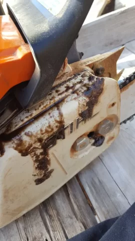

What would cause this?

Clogged passageway? Need to get some small picking tools to clean everything up.
i would take it apart and clean it up. see if that doesn't do the trick. could just be really gunked up
Air compressor and a blow gun works better
Yup. Looks like a lot of very fine flour like dust on your felling dogs, usually from a dull chain. I'd bet you need to pop off your bar, blow off and brush off the oil channels, clean around the clutch and in all the grooves of the bar and oiling passages, and you'll be good as new.
Never had an issue with the chain oil. But I maintain it often. I've always wondered if you could tell the oil feed was plugged up. That is before the chain smokes. I have the oil feed wide open. More is better. With every fuel fill, I fill the oil. The oil is about half empty. I pull bar, often and clean everything.

see that hook ..run it down the bar to clean out the grove..
Then flip the bar once in a while...
Plus don't forget to sharpen the chain so you don't get saw dust.

OP has a very dull chain to be able to create the fine dust that seems to be all over that saw.
