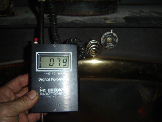

those temps are way too high to be accurate .. consider verifying your cat thermometer against a digital pyrometer .. mine read 200f degree low.
my Buck 91 is set to cruise at 1,200f

where do I find such a device and what's the cost?
On your Buck I think you could use the Condar Digital Cat probe, the thing to make sure of is that it is reading from the exhaust side of the cat about 2-3 inches back to get correct readings.
If not, pickup an AT-100 and a k type 2000+ ::F thermocouple from Auberins.com, that would be around $80.
no need for a new pyrometer if you have a way to calibrate. existing thermometer has a nut to loosen to move dial. don't assume your new pyrometer is accurate either.
probe tip is directly above cat .. when taking temp with digital pyrometer. place tip at same location. also it's nice to take a reading barely off cat so you can tell difference between cat surface temp vs air temp 2in away.
