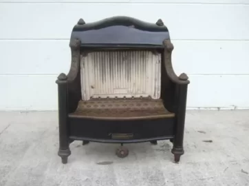

I would think given the chimney seems to be sealed off at both ends - and likely very suspicious condition in between - then you'd either be looking at major rehab work, ventless gas, or electric. The coal baskets linked above look really neat. Some of the gas radiant heaters:
I believe they even make electric coal baskets and possibly even electric radiant heaters, too.

Thanks guys! My parents house a mile from here had one of those radiant style gas heaters so I think you're onto something! I sincerely appreciate the input, it's been driving me mad trying to sort out how it was originally! I think ventless gas is the route I'll be taking due to cost constraints.
