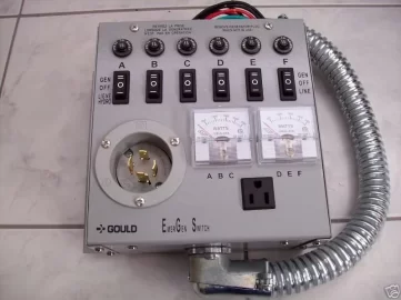

Heres what I use. Cost $86.00 and took a couple hours to mount and wire. I use a 6500 watt generator. Just pick your 6 most important circuits. Actually if you run your 220V (double breaker)water pump then you only will have a choice of 4 other circuits.
  • [Hearth.com] Whats your back up when you lose power

http://www.northerntool.com/webapp/wcs/stores/servlet/product_6970_200196674_200196674
This is what I bought for the money its not bad,and a friend who's a licensed electrician installed it for me.
Way too expensive...
$150.00 Brand new 30 amp transfer switch
(broken link removed to http://cgi.ebay.com/6-CIRCUIT-EMERGEN-SWITCH-MANUAL-TRANSFER-SWITCH-6-7501A_W0QQitemZ260507589279QQcmdZViewItemQQptZBI_Generators?hash=item3ca7765a9f)
I bought mine from this guy. My licensed electrical friend saw the unit and bought 2 from this seller also. Goes for $275 + tax at HD
