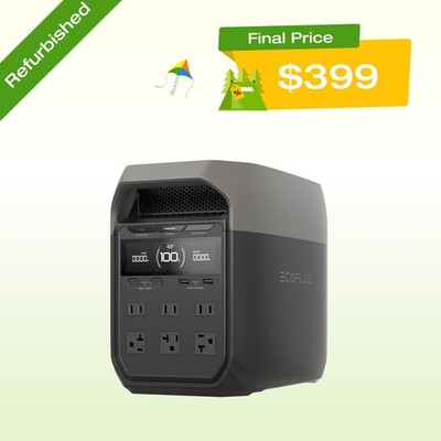

Eco flow delta2. Refurb for $400. New for 5-600. I got a refurbished alternator charger off Ecoflow official eBay store and it was like new.
I like mine. Charges in under 90 minutes.
