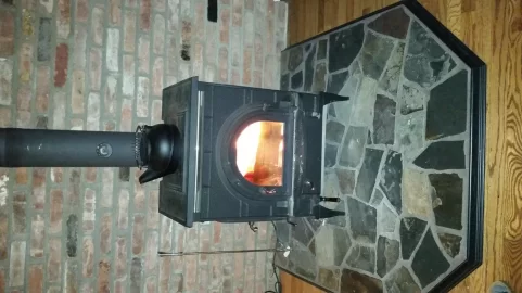

Here's my US Stove 2200. It's got a small firebox but it puts out great heat. Down stairs 76 up stairs 71 right now.

Cracks, broken hinges, broken door latch. All in two years.
One thing is that the inserts in the value stoves are on the small side.

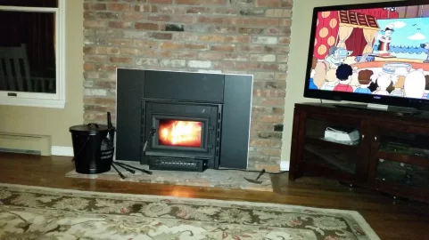

My budget Vogelzang Defender has been working pretty well for me if anybody cares

Its a very heavy duty firebox. I also have a vermont castings at the opposite end of the house. Again not a huge box but great so far. And this was in the house before I bought it. My house was the same temp when it was frosting Sunday night at 74 to 80s while 31 outside.
