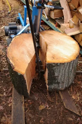

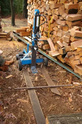

A good trick that I was just taught for splitting your huge rounds, providing the round is in fact round and rollable is to put a pipe in front of your splitter. Then roll the piece over and let it fall onto the pipe. Having the pipe under will allow you to reposition the piece quite easily. A pickaroon or a pulp hook makes the final jockeying that much easier also. The hardest part is getting the natural flaw in the round that you want to split on into position before you push the round over. You can avoid the noodling entirely on wood that is willing to be split. My 16 ton went through my neighbors 37" DBH red oak without a single noodle that way. Just needed a little assist with a prybar to open it all the way up. (His tree service bucked and delivered.)
rounds I've been getting are just too big to move even with a full size peavey. no way with a little pickaroon. for 3ft logs it's just too much effort to wrestle log into splitter, then rotate log, etc. vs Stihl 660 noodles logs down to size with little to no fuss in 2-3 minutes. I'd spent way more time muscling that 3ft log to split.
now if I wasn't setup with large pro saws .. I'd be splitting those 3ft rounds with splitter. have split many a 3ft+ round with 35 ton speeco, until I figured out it was much easier to noodle.
