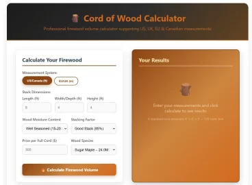

I’ve been working on a little firewood measuring calculator tool, but I’m running into one question I can’t quite settle:
When adjusting for stacking factor (tight vs. loose stacking), I’ve been using these ranges:
  • Loose stacking: 70–75% of full volume
  • Average stacking: 80–85%
  • Tight stacking: 90–95%
Do those numbers seem right to you folks who’ve stacked and burned a lot of wood? Or do you find your actual usable wood volume comes out different?
I’m trying to make my calculator as accurate as possible, so any real-world input would help a ton. Here’s the tool if you want to see the whole calculation breakdown: https://woodstovehub.com/cord-of-wood-calculator/
Also curious, how do you factor in moisture content when estimating BTUs? I’ve been applying a percentage reduction based on MC, but maybe there’s a better approach.
  • [Hearth.com] How do you all estimate your firewood in cords/BTUs?
save yourself some time it's already done.
Thanks for sharing, I hadn’t seen this calculator before!
Looks like it’s solid for just figuring cords from measurements, but I was kinda messing around with extra stuff like BTU estimates by species, adjusting for moisture, how tight the stack is, and even a rough cost value. Mostly for my own curiosity (and because I overthink firewood way too much 😅).

no matter how you stack it, a cord of firewood is 8x8x4. Here is a chart already done for you
On this forum over the last couple of decades there have been a few "overly academic" measurers. Those folks, the smart guys, ended up weighing each firebox load and logging it along with moisture content. Then they could calculate the BTU input required for a given weather condition at their home and with their stove installation. Then could tweak things for maximum efficiency.
You'll probably notice that wood fuel BTU is pretty constant on a per lb basis so volumetric calculations are pretty pointless. You'll also probably notice that your best bet is to be at least three years ahead on your firewood stash to allow proper drying amongst other things. By doing so you can recover easily if you use too much wood one year.
I used to weigh my wood to load the stove many years ago when I had a Tulikivi, and I started doing it again last season. I use a dariy scale and a sling. This year some white pine mixes in with the hardwood, so it makes even more sense for me. Assume the wood is dry and go by weight.
