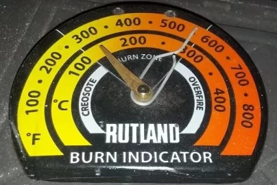

![[Hearth.com] When is it Safe to go to Bed? [Hearth.com] When is it Safe to go to Bed?](https://www.hearth.com/talk/data/attachments/126/126042-09d088f5f92ec194919127b1cc558a57.jpg?hash=Y3lxjasKAG)
I've posted this before, but if you've got a stovetop thermometer, bend a paperclip like in the picture, then you will know the maximum temperature you've reached overnight or when you leave for work, etc. That way you will know what happens as a result of your loading settings and over time become confident in leaving the stove a bit earlier. Any mistake you make causing an overly high temperature (or a smoulder) will be something you don't have to repeat. I almost always leave for work with four special people still asleep in the house and it gives me a lot of peace of mind to know what happens after I leave.
