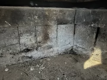

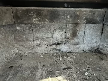

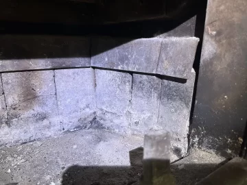

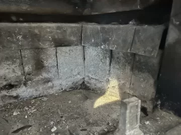

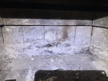

It's been 10 years. The bricks cracked but still standing. Are there any benefits to replacing them?
[Hearth.com] When is the time to change the bricks ?[Hearth.com] When is the time to change the bricks ?[Hearth.com] When is the time to change the bricks ?[Hearth.com] When is the time to change the bricks ?[Hearth.com] When is the time to change the bricks ?
The main benefit is when they start falling apart into the fire. One option would be to swap out some floor bricks with them. The cracks are less likely to be an issue there.
I’d just put some new ones in in place of the cracked ones. Simple and cheap enough
