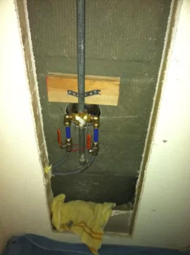

The issue I had yesterday was a shut off valve that just cracked right through the center of the casting for no apparent reason.
When I installed them a year ago, the first one I installed had a pin hole in it at nearly the same spot as this one cracked, and began spraying water all over when we pressured it up.
A bad omen.
Yesterday while soaking up the mess the other valve began dripping at the packing nut, again for no reason.
JUNK

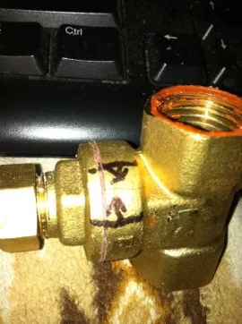

I sawed the valve that cracked in half, !!! the casting is full of sand, slag and porosities
Crap looked like rice cakes inside. Arrrrrrgh :(
WE are currently shopping for a new faucet for the kitchen, NO China stuff NOOOOOOOOOOOOOOOOOOO WAY.
I am still drying out the closet carpeting and pad where the water leaked into.
Likely be another good day to get it all dry before I lay it back and tuck it into the tack strips.

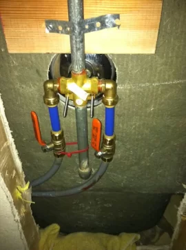

The new Sharkbite ball valves are all in now and work sweet.
Some pix now and a shot of the broken valve.
Keep in mind that this valve had been in place for about a year and was on the cold water side, with a max of 60 psi WP
The crack is easy to see between the sharpy marks.
This tiny crack was really putting out a buttload of water too.

Thats cast brass. Probably cast in some backyard pot... Hard to find forged brass stuff, but thats what you want.
Used to be able to go into the HRDWR store and buy good quality parts, not no more China on nearly everything.
I really love the AUSIE shark bite. Top notch stuff
Those shark bite fittings are pure MAGIC.
Reactions: F4jock
Parker fittings are what I use. They're made in the USA and are the best. I'd use a Parker with compression fittings before a Sharkbite. Sharkbites are good but I would only use them where they could be inspected periodically or where there is no room to use a Parker.
