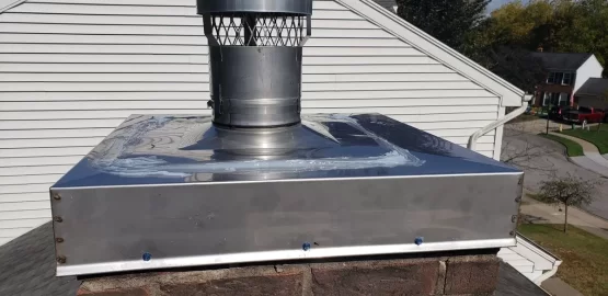

I cleaned out my masonry flue and smoke chamber which was a 15 foot tall 2 foot by 2 foot brick chimney with a 12 by 12 clay tile running up the middle and relined it with preinsulated rockflex 316 ti. I then stuffed as much roxul as i could get down from the top all around the liner and capped the chimney with a new stainless steel chase cover and made sure everything was shingled properly up to the top cap. I then stuffed as much roxul as i could get up around the liner into the tiles from the bottom and filled as much of the smoke chamber as i reasonably could and made a sheet metal block off plate.
