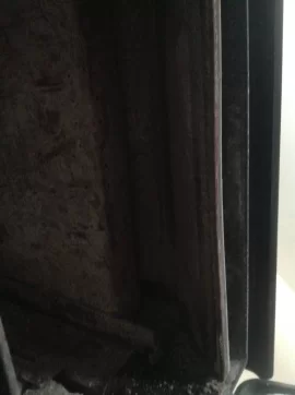

I have noticed my stove has a tiny gap for the smoke to go above the baffle.
Other Pacific energy super 27 have a much larger gap. (i think)
Is my stove a early unsuccessful version?

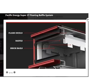

The Super 27 is an easy breather. Normally it's not too fussy about chimney height. Measure the gap above the baffle and post it here so that others can compare. I would expect it to be around 1.5" - 2". Have you pulled the baffle out to verify that the flame shield is properly in place?

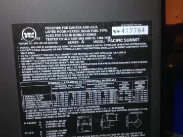

There should be a tag on the back of it that has info about it. Could you give us that info? It might help us date the stove for you. begreen's suggestion is where I would start too. make sure the baffle is installed correctly and measure that gap to give us a starting point. These are great stoves with great reviews hopefully you can get this sorted shortly. Also more information on the actual chimney would help, things like height, number of elbows along with pictures really helps us to see what might be going on.

The baffle has been out a couple of times, both to clean and inspect, never seen a problem. It is exactly as you see in the picture of my 1st post.

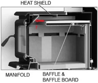

I know other people that have the same (well i mean similar) stove but there's looks this this with a 2 to 4 inch gap for the smoke to get above the baffle. see picture

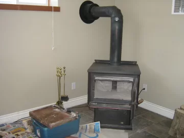

Any way you can ease those 90's? Picture(s)?
Here is a old picture of inside the house. That 90 degree was replaced last summer with 2 45 degrees.
Outside the house the 90 is the T (with clean out) so I cannot change that.
This picture also shows the baffle out for cleaning.

It looks like a very poor fit where the stove pipe enters the stove top. I'm not sure if this was fixed (or made worse) when the 90 was replaced with two 45's but it doesn't take much of a leak to kill a draft that is already weakened by the two 90 bends. Depending on the brand of stove pipe, there can be quite a significant leak at the rolled seam and, if the pipe isn't inserted fully, or it's inserted at a slight angle, the leak can be magnified.
Good eye. Actually the new pipe is a worse fit then the one in the picture.
We are going to have a warm spell this weekend, i will fit a new pipe here. This time i will make it tighter.

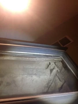

If you look at the picture i attached in post #5 then look at this picture. It seems to me the heat shield is not in the right position. It is not in the slot, so it is way to low. What do yous think?

I had a warped upper heat shield on my Summit that I had picked up used. It was an easy fix to replace and very inexpensive. You may want to try that. If I remember mine it went in above the window wash air intake along the front to hold it up and was fixed in place by a single bolt that was accessed by taking the chimney pipe off. The warped one had dropped down below it and had pinched the exhaust air flow down a lot. Hopefully that is your problem, you should be able to tell quickly as it should be all but tight against the underside of the top of the stove. Let us know what you find as this is a good stove and I/we hate to see it being a problem for you.

If i understand you about the heat shield, then this may be exactly what my problem is. My heat shield , the part you can see at the front of the stove, is below the thing (window wash shield) and should be above.
I will find out this Saturday when i take it apart.
