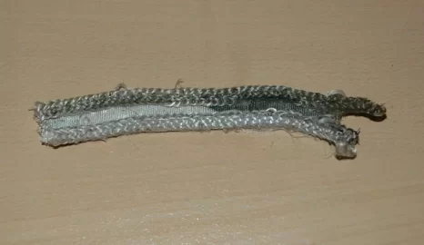

One issue I have run into with mine is I am replacing all the gaskets in it, I am having one hell of a time finding the same exact window gaskets that came out of it, or should I say fell out of it.
Guessing I am going to have to just use flat gaskets and fold it and clamp it down.
Yeah my gaskets do look like that, The thicker rope gasket that goes around the door frame belive it or not i got at home depot. The one that holds the glass in they have at my local fireplace store.
The brand is RUTLAND it is adhesive stove window gasket tape 11/16" . It worked great and was soe easy to use. Let me know if this helps you
