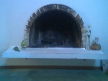

Hi, I am new to the forum and have read a lot of information over the internet about fireplace inserts... I'm sooooooooooo confused. I've just now stumbled onto this forum and read some of the posts regarding selecting a wood burning insert. I'm still at a loss how to tackle this... My biggest challenge is that I am a renter. The house is currently heated from an old heating oil furnace that is costing us a bundle and it hasn't even gotten cold yet. Last year the first time we had to fill the tank was just after moving into the place (100 gallons - it just about did us in) and then the reality of our mistake sunk in. Problem number two, we still don't have much in our budget. The third thing that I am concerned about is I do not feel good about our landlords abilities to have anything to do with choosing one or the installation of something that may be acquired for the purpose of keeping us warm. Other than his permission! This is a 3br - 2 & 1/2 bath with a loft that has a vaulted ceiling over LR. The windows are single pane, aluminum sash, and I can't even reach two of them so using plastic will only help so much. I'm attempting to find a viable way to keep from running the forced air furnace so much as the electricity to power it and the cost of the heating oil combine to be astronomical. Help... I haven't even talked to the landlord yet because I want to be well informed first. There is a masonry fireplace, that measures about 36" wide X 27" high X 42" deep (of that 18" is the depth of the hearth). The top of the fireplace is arched and the box (of course) tapers inside so measurements of an insert will need to take into account these variables. Is it even worth looking into getting an insert- - -it might need to be a cheap or free one- - -is that safe?

I would think you may be able to stick a Englander NC-13 in the opening...........Guys........

Something like this would fit but is probably out of your budget.
(broken link removed to http://www.quadrafire.com/Products/Wood_Burning/Wood_Model.asp?f=3100Iact)
Going by that it seems many inserts would fit, just so they clear the lower sections of the arch. Since your hearth is only 18" you probably also want to look for a flush insert or you will have to extend it.
Lopi makes some larger size flush inserts
(broken link removed to http://www.lopistoves.com/product_guide/detail.aspx?id=219)

From the picture - I think that's going to be a little bit of a challenge to get any insert or stove in there that will heat well and at the same time not have to make any alterations to the existing fireplace.
I think I'd talk to the landlord first, and see how receptive they would be about changing what is there. Certainly there's a lot you could do there to reduce your heating costs, but it may not be worth it if the landlord doesn't want any changes there.
The chimney liner is going to be the killer. I think you can get lucky and find a stove that might fit....maybe for less than $200 or better, but you have to install it. Check the size of the flue tile, and get back to us. Also, is the chimney interior or exterior?
If you can get away (depending on answer) with just a "direct connect" installation, you will spend about 150-200 on material. If you have to reline to the top, a DIY will be about 350 - assuming you (or a good friend) are very skilled.
So, roughly speaking, 500-600 at the lowest end if you get lucky on a used model and also have handy friends. Too bad you don't live in mass. or near Corie or some other members......some of the folks here have done some "barn raising" for those in tough positions like you.

The other issue is sometimes (in my case and others I've read about here) to get the insert properly installed, and liner put in, permanent modifications are needed to the fireplace (i.e. damper cut out). Would your landlord allow that? Once done, some mods make the fireplace un-useable.

I agree that a flush insert should be what we concentrate our efforts toward obtaining. We can then still take advantage of the hearth. We will absolutely talk to the landlord first, as a matter of fact I plan on (if we can put this together) surpassing "his standards" just so I'm clear on the safety issues, and being covered for any and all legal points before they can turn into problems. We wouldn't want to take the unit with us when moving - - -just not a good option to think about- - -so we'd be "asking" for a kickback from (or some deduction off rent to offset) our investment. Might even get our socks blessed off by our landlord offering to carry some of the initial cost, should he be feeling able and willing to be a big part of this, it is his house after all. He had spoken to us when we moved in last February that he'd thought of "someday" putting in an old insert he had...
The chimney liner ??? Check the size of the flue tile ??? Also, is the chimney interior or exterior? It is exterior. Well, one out of three...
