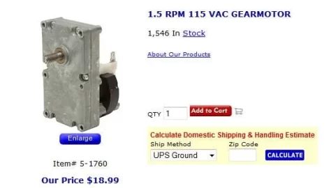

    Specs on Auger Motor Pic1 below.
    (Is 1.5 RPM close enough to a 1.0 RPM for replacement??)
    The price is right!!
    1.5 RPM 115 VAC GEARMOTOR
    New, Merkle-Korff inline gearmotor. Model 4590UI-046. Made to drive auger on corn/pellet stoves. Aluminum gear housing. Six 10-32 bolt hole face mount on 1-15/16" - 4-5/16" x 2-3/8" centers.
    SPECIFICATIONS
    Speed 1.5 RPM
    Voltage 115 AC
    Amperage 0.6 Amps
    Torque 16 in. lbs.
    Rotation CW
    Duty Intermittent
    Enclosure Open
    Mount 6 holes on face
    Shaft 3/8" dia. x 7/8 w/3/8-16 LH thread
    Size 2-3/4" x 2-3/4" x 4-3/4"
    Shpg. 3 lbs.

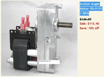

    Specs below on Auger Motor Pic2
    Model: PP7000-PSP-WHS 12-1010-EPP
    Shipping Weight: 4lbs
    Manufactured by: Avalon
    This auger motor fits many pellet stoves including these: Avalon, Lopi, Envirofire, Whitfield, Waterford Erin, Pellet Master, Regency and Heat N Glo Pellet Stoves. This motor has a clockwise rotation as you face the auger shaft.
    Breckwell part #C-E-017 1 rpm pellet stoves
    Envirofire Part#SIEF001
    Avalon Part#90-0191
    And all Whitfield Pellet Stoves
    This auger motor also fits most stoves requiring a 1 rpm motor
    with a clockwise rotation when facing the auger-shaft side
    Replaces ECM 1 rpm
    shop notes PP7000-PSP or 12-1010-EPP
    Product warranty one year

    I'd use a gleason Avery. One of the best built out there. You can buy direct. Less than $100 clams and continues duty rated!
    IMHO Don't waste you money on an intermitten duty motor.

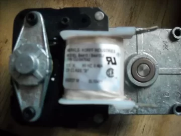

    Hello
    New Merkle-Korff Ind newer design Auger Motor for Pellet Stove - Hear how it sounds
    Merkle-Koriff Industries
    B4415 /B4415UI
    P/N CU-047042
    115v 60HZ 0.40 A
    Z P Class "B"
    ES3737 M SL10411
    Same as this Merkle-Korff on the England Stove Works Web Site
    http://www.englanderstoves.com/store/10-CDV_Parts.html
    CU-047042 2.4 RPM Motor (4 lbs. each)
    $130.98
    2.4 rpm auger ('feed') motor for our Multi-Fuel unit - models with 10-CPM, 49-SHCPM, 49-SHCPML or 49-TRCPM in the model number.
    ALSO is the auger ('feed') motor for the pellet utility furnace (models with "PUF" in model number) AND the Pellet Auxiliary Heater (models with 25-PAH, 55-SHPAH, 55-SHPAHL or 55-TRPAH in the model number).
    ALSO is the stirrer motor (turns the stirrer) for the Corn Stove - model numbers 10-CDV, 49-SHC22 or 49-TRC22.
