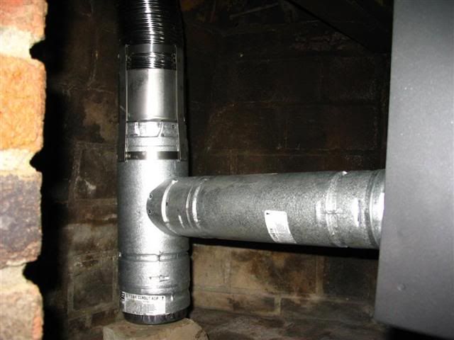

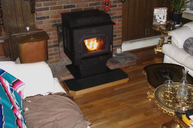

My free standing vented up the chimney with a full liner and capped:
[Hearth.com] Where to put pellet stove in house?

stoveguy2esw said:
true enough zeta, i love your install personally. nice clean setup, you might post the picture you have of it for this poster to look at. its quite nice
Looks good
but that horizontal run from the stove to the T looks like it is going down hill a little
I would try to pull up on the pipe more or prop the pipe more (i see the brick you have now) up so you have a little rise.

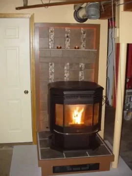

I went the basement install route and cut registers into the first floor. Many of us on the forum are very successful heating both the basement and 1st floor with one stove by adding the registers.
Also my stove is right near the stairwell to the 1st floor which is a tremendous help.
So It is a matter of home layout here, which is the best way to go. Good Luck
