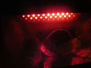

What about the catalytic element, how tough is it to remove (for
superficial or complete cleaning) ?
Looks like they want double-wall pipe all the way down to the stove
exit, but the Dutchwest is drafting fine with 5ft or so of single-wall
'til it hits the support collar for the double-wall chimney.
I dont know, Never done it. It looks pretty easy. Two nuts at the top front hold in a piece of two inch stainless channel that drops down and holds up or secures the catylist. Looks like theres a small gasket around the perimeter to replace at that time too.
Here is a picture of my Cat after lightly brush/vac on year 3.
