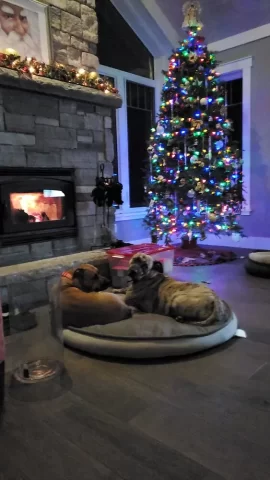

We put in the fp30 and are very happy with the heating g capabilities in our new build home.
We also added the remote heat duct kit which is/was available directly from pacific energy. It works well to help heat our basement and relief from overheating our main floor (where the stove is located)......this fan is much louder than the fan under the firebox. I would consider using a aftermarket quieter fan than the offered directly from the manufacturer. IIRC KC2004 has high regards for the fan he installed.
For reference our fp30 is heating 3160 sqft main floor and 3160 basement on the coldest windy winter days.

Congratulations. That is a very well insulated and sealed house and a nice FP30 install. Is the fireplace in the basement or main floor. If main floor is the basement heated by remote takeoff from the fireplace?
PS: Cute pups too.
It's a main floor install.....I'm thankfull for the cathedral ceiling and large stove room. The 3' of ceramic tile in front of the hearth is also a nice piece of mind. With a 5' ceiling fan and a open centre staircase to the basement I'm amazed at how even the temperatures are throughout the entire house. Here's this year's Christmas tree as the last pic was from last year.

It's a main floor install.....I'm thankfull for the cathedral ceiling and large stove room. The 3' of ceramic tile in front of the hearth is also a nice piece of mind. With a 5' ceiling fan and a open centre staircase to the basement I'm amazed at how even the temperatures are throughout the entire house. Here's this year's Christmas tree as the last pic was from last year.View attachment 288235
