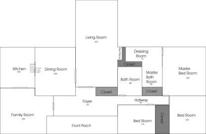

As for how I will use the insert. The house is a one story ranch. I will reposted a diagram of my house on this post. I would like to heat the whole house but I would be happy with heating the common areas. I may heat 24/7 but I'm not sure yet. I hate cold weather and I'm a hermit in the winter time. So, even if it's not 24/7 I will use it alot. The room I'm puting the stove in is the formal living which I don't use alot anyway. I do have a projection TV in there, so I watch a few movies in it, but it's not the main room everyone hangs out in. Still I am concerned about over heating it on movie nights.

Looks like a tough layout to heat. Especially the bedrooms.
No matter what size stove you buy, you'll have trouble heating that layout. If I were you I'd seriously look into either a soapstone or a stove with a blower. A stove like a Jotul (sans blower) or VC, or Morso that is pure radiant will likely cook you out of that lr if you're trying to heat the whole house. Now, if your willing to keep that room hot, you'll heat the rest of the house somewhat, but your doorways are too few and too small to do a good job. You'd be better off with a couple smaller stoves in the 1.8 - 2.0 cuft size. Any way of adding something to the family room?
I think you guys have mistunderstood something. I am buying an insert not a stove and they have blowers on them. Also, the two doorways in the living room are six feet wide. Also there is a butlers service between the kitchen and the dining room. It is about 5 feet wide and 3 feet high. You can almost see the fireplace from the kitchen. I'm sure its not an ideal house to heat with an insert, but I don't think it is anywhere near the worst. Warren, I currently have a 20,000 BTU ventless gas heater in the family room. It heats that room and the kitchen very well. Infact, you can't leave it very long or those two rooms get too hot. I am hoping to get away from using it, but it's there if I need it. There is noway I could put anything in the family room. I've thought about it and with the furniture in there, I just can't do it. I don't mind having to use a fan or two to help move things around. I know it makes a big difference. The ventless heater does a good job of heating the two rooms but when I put a fan in there. It will roast you out in a heartbeat.

OK, thanks for the refresher Karl. The house will be a bit difficult to heat with just the wood stove due to the sprawling nature of a ranch house. As an area heater it is possible that the bigger stove may be too much. You may be right, the Naploleon may be fine, and you might also want to look at the PE Pacific Insert instead of the Summit and also the Lopi Revere and the Quadrafire 4100i.
