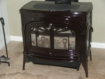

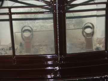

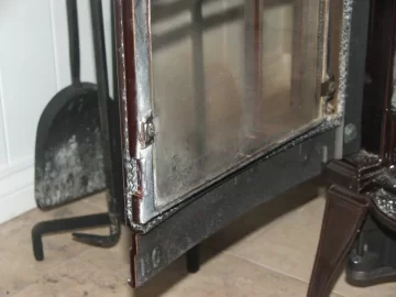

Hi, I have a VC Encore 2 in 1 that I bought new and have been burning only one week today. I've been burning 24/7 but woke up to the fire out and decided to clean the glass. I cannot get the white foggy stuff
on the lower portions of the glass to clean off no matter what I do. I even tried a razor blade to no avail. Was wondering if anyone had any suggestions and if this is normal? Or do I have a warranty claim? Thanks

How dirty was the glass before this appeared after cleaning? I've heard of gunk etching the glass. I've got a small spot middle top of my glass where the secondary flame always laps when it's cooking. Kinda annoys me when at the coaling stage and I notice it more
It was crystal clear. It's a new stove. If it's etched, can it be cleaned? It's really disappointing that it looks this way.
eventually, that 'fog' will happen to the glass, especially where the glass is exposed to the full force heat of glowing coals. I'm gonna go out on a wire here and say that the natural minerals in firewood is what helps cause that fog. I have the same 'fog' on the glass of my Napoleon 1900p. Last summer I had intentions of trying some of that CLR cleaner (calcium, lime, and rust cleaner) that you use in the bathroom....but forgot all about doing it. You have to remember that the glass on these stoves is not normal glass......it is a ceramic material. Normal glass would never hold up to the severe heat that the woodstove puts it through. At any rate, your fogging is more or less normal, I'm betting that most of us have the same thing.
Did you try a mixture of vinegar and water? That works for my white fog.

Have you been burning it with the ash door open? White fogging is usually caused by etching caused by ash particles being blasted against the glass, and this is greatly accelerated if the ash door is regularly left open to help start a fire. Etching is pretty much non-reversible and treated by replacing the glass. Only thing is, this usually doesn't so quickly, even if you do leave the ash door open occasionally. So there is some hope it may be something more easily fixed.
However, it may be VC has found another way to cheapen the stove, and is using a softer grade of glass. I'd try the cleaning methods others have suggested already in this thread, and if none of them work, file a warranty claim with the dealer (and if you have been leaving the ash door open, don't volunteer the fact).
I tried moist newspaper dipped in the ashes, it only took care of the upper parts of the glass. I even tried some bar keepers friend for a mild abrasive (that's all I have on hand) and it didn't do anything. I razor blade seems to get some of it off but that's with ALOT of pressure and it doesn't get it all. It doesn't seem right. Most everyone I read on this forum have easy success with the newspaper and ash but that doesn't cut it for what I've got. It's like it's baked onto the glass.
I do leave the ash door open occasionally but only for 5 min or so and only to get the wood going again. I hope that wasn't it. I know one time I did and forgot about it for about 10 or 12 min and the stove was really hot (just above 700). Had I known that I wouldn't have done it. It's just a lazy way of getting the thing up to temp again for me.

I didn't clean it for about 5 days this past week as I kept it going full throttle. We just love the heat this thing puts out. It's a great stove and I have no issues with it's performance at all as of yet. It's just so pretty to look at and the glass is one of the things you expect to enjoy when you pay 3K for a woodburner.
I get the white fog sometimes, but the ol' wet newspaper dipped in ashes and rubbed on glass does the trick. If you can't get it off with a razor and/or any of the above tips, it sounds like this may really be a glass issue. IMHO, anything you burn within any range of temps which don't reduce the stove to a puddle of liquid iron should not really hurt the glass. I've had logs fall forward against my glass, stove top temps of 900º+ and dozens of cords of hedge wood through my stove and the glass is fine.
A few years ago, someone mentioned their stove came with a warning to the effect of installing the glass with the metalized side out, but they couldn't tell which side that was. It seems the factory was applying a (nearly transparent) metal coating to the glass to keep heat in the firebox for a more complete burn. If this coating was installed on the 'fire' side, it would quickly oxidize, so it needed to be out on the 'room' side. The solution - which reportedly worked - was to take a volt/ohm/amp meter, set to read resistance, or ohms, and put the probes close together, but not touching on each side of the glass. The pure glass side was an insulator and read infinite/high resistance, while the metalized side of the glass was conductive and read some low ohm / conductive reading.
So, the bottom line to all this jabber - sometimes glass has a 'right side' and a 'wrong side' to be installed to the fire, this can be detected with a meter capable of reading ohms. If your stove has this type of glass, and the low ohm / conductive side is on the fire side, that may show the glass was installed wrong and the metalized coating has burnt off leaving a white oxide residue.
If the glass is etched, none of these cleaning tips will do a thing. I would say that leaving the ash pan open for 10 minutes could have done it. That could have done a lot more damage than that. That's why it's such a bad habit to start. If you forget bad things will happen.
