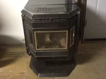

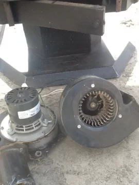

[Hearth.com] Whitfield control board question [Hearth.com] Whitfield control board question Pics....:):) I bought another used stove that the owner said the room air blower was shutting off. Both motors and windings were very dirty with dust and hair. Cleaned and oiled both motors, replaced door gasket and a very good cleaning. Runs like it should now. These old stoves are excellent. A great thanks to this forum. The knowledge and people here on this site are incredible.
