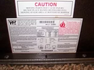

I did and all it said was (WH-Q 32880) on the cover. I removed the back cover to see if it would give me a clue but it didn't.
Doug

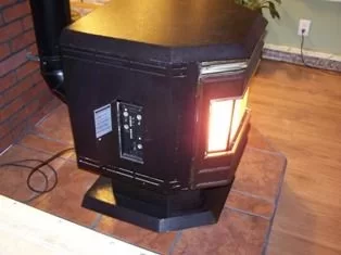

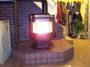

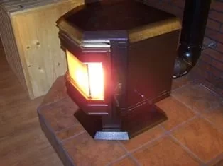

Here are some pics.

well I have a profile 20 and that looks like it... hard to say for sure.. let me take a better look later. Also on the tag right above where it shows the installation pictures is where mine says profile 20... I didn't find it for a while
JF254
Yup I did find it in the description where you said to look. (WP4 Quest)
Doug
yup quest plus. Small 32k BTU pellet stove.

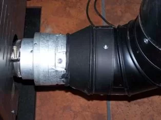

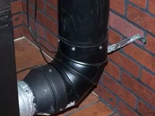

Looks like a 6" exhaust on a 3" pellet stove?, lets see some pic's of the rear exhaust pipe
Pellet-King said:
kdvois said:
Here are some pics.
I took a 3" to 4" adapter for a pellet stove and lined the inside of the adapter with stove door gasket and and 2,000 degree gasket sillicone and inserted a 4" to 6" stove pipe adapter into the gasket and sealer then using self tapping screws secured the pellet adapter to the stove pipe adapter the sealed around the 2 fittings with black stove pipe mortar. The reason why I did it this way is that all the stores around my home wanted $50 to $60 for a 3" to 6" pellet adapter fitting and I did the whole job for $18 and it works great.
