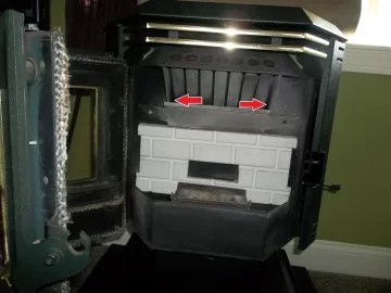

Here is where the exhaust ports are located. Take off the deflector plate and you will see them.

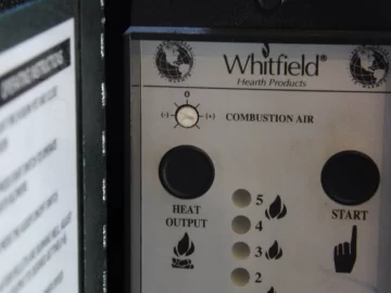

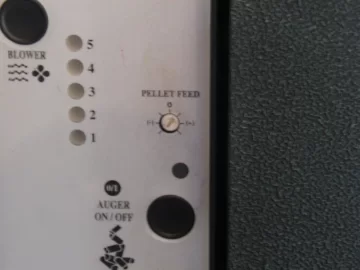

Now that you have the service manual you can verify if the pellet feed rate of your auger motor matches the feed rate chart on page 10 in the manual.
Through the years I remember several Quest stoves with worn pellet feed control... the feed control knob loses its grip on the potentiometer, so that nothing really happens, when you turn the knob. This could very well be the case in your stove, so please take your time to check if the feed rate changes, when you turn the knob.
Sounds like a good check with the potentiometer. Hows life in Denmark? Both of my Quests have the push pull damper on them, haven't seen the one with the cable...do you have to pull the exhaust motor to access the damper or does the stove have an access port of some kind?

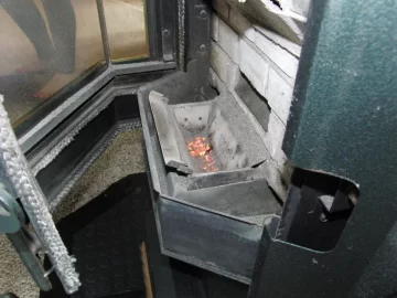

Sure thing. Really good success and adjustability. I have the stoves running but here is a quick picture. This is the newer burn pot with the grate style bottom and the flip flame guide on the front of it. if you look on the sides of the pot, I have a piece of metal shaped like a wedge, spot welded so that it covers the first opening on the bottom of the grate and rests on the 1st rod on each side. I used a 1/8th piece of steel . make sure it sits pretty flush to the sides, two near the bottom and one toward the front of the pot. The intent wasn't to funnel the air more into the center, it was to consolidate the pellets to a smaller area. I tested it with bringing it in two rods on each side but the air flow was a little too high when it was on 4 or 5 so I kept it at 1 rod in. Works nice. I just took this picture and you can see the nice combustion I can get with it and it has a nice low burn on 1 and really kicks butt on 5 if i need it there. I played with my potentiometers to dial it in with the combustion and pellet feed here is where I have them set for this one but I think each one is going to be a little different. (play with it a little) One of the things that I did on the other Quest was I closed off the top portion of my slide damper when I had it apart (don't have any pics of that...should have taken them) as I mentioned above, I had about 5/8 inch x 1 1/2 inch gap at the top and bottom of where the damper slid across the opening (from the factory that way) so I could only adjust the airflow down to a certain point and even though the exhaust blower speed varies at different heat settings, there were times when I would have the damper shut all the way and the combustion blower would bounce the smaller pellets out of the pot and when I would drop the potentiometer down, I wasn't getting enough air pulling through at the lower settings. What I did was weld the top section of the opening shut to allow me to damper the stove down really far which gave me more adjustability. It works really well for me. I know the theory on these and how they were set up to burn without messing with them too much but I live in the real world where air flow gets restricted from ash, pellet mixes change, Impellers start to get dirty and so on so I do like having the ability to adjust it. I just installed my other Quest in my brother in laws house for him (his electric was killing him) but the advice i gave to him is to keep it clean, understand that there is a learning curve with each stove and know your flame. Sounds pretty simple. How about it.
I just took one of my Harman P-38's with manual light and switched it over to auto light for under $100 and that includes the igniter. (shouldn't let that on get out) It was simple. Crank timer wired into the power cord feeding my igniter. and it looks good. (last picture)
I like messing with these so it's not like it's work to me. I wouldn't buy a new stove knowing what people sell virtually new but used stoves for. but thats me. Good luck with your Quest. they are great stoves. I'll be traveling through your area next month for a trip up to Maine. One of my favorite places to go.
Bob

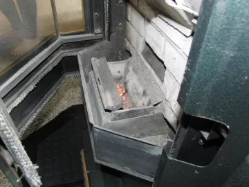

I'm curious. What does the flame guide on the burn pot do? My Quest is a WP4 older model. The burn pot has a flat front, parallel to the stove door (no adjustment) and an oval feed chute (not square like the Plus).

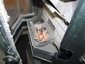

Glass fogging up..here is a picture of what the pot looks like with the flame guide up while it is burning. on this pot, it is a flap to prevent the flames from going toward the glass. If I leave the flap open, the glass will ash up quickly like yours probably does but when i flip the guide closed like you see in the picture, it makes a big difference in how long the glass stays clean and it guides the flames to the heat exchanger really nice. This pot has the flap on it. My other stove I cut an inch piece the length of the pot, bent the edges down and welded it to the front at the same angle. (thats the nice thing about having two identical stoves, I was able to use the one with the flap as a template) I have pictures of it somewhere but not on this computer.
I know that most people don't have a welder and means of cutting and bending metal which makes a modification like I'm telling you difficult. However they do sell the same burn pot with the flame guide/flap on it. It is worth getting it or if you have a local welder, see if he can weld a piece of 1" bar to the front of it. I will try to get you an angle on that piece (I don't thing it has to be exact) Might be worth getting the new pot if yours is starting to wear.
I gotta run but I will work on getting you some pics of the modified pot and some measurements good hearing from you
Bob

My burn pot front is a steel plate that sticks up about 2 in; from the base. Sorta like if your flame guide was vertical. Seems like it should almost have the same function, maybe not as efficient. I'm thinking that the guide might also aim the fire at the door edge of the heat exchanger for more heat. My flame burns straight up or to the rear, ignoring that area. Anyway.

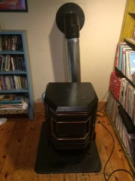

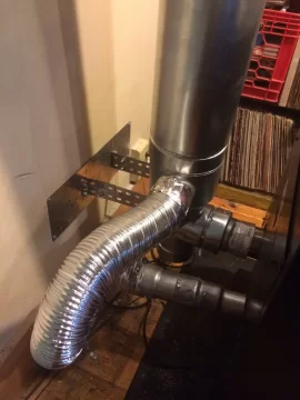

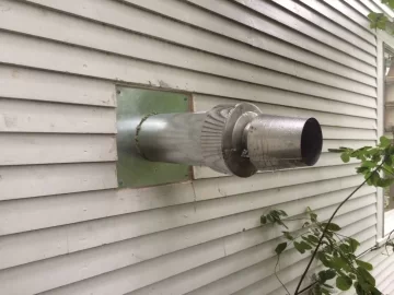

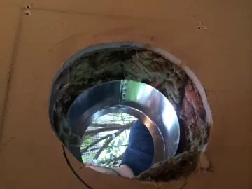

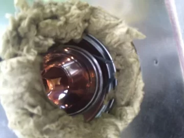

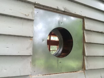

Hello

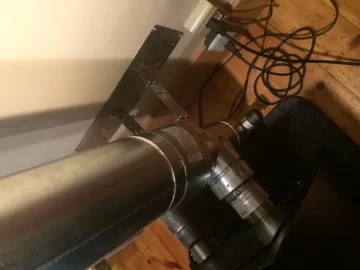

One great improvement is installing Selkirk DT, this warms the burn air and adds 10% to the efficiency. By warming and drying the burn air you get a lot less caked ash in the burnpot! It is like a Quest on Steroids! See my pics below.
Also I used 100% fire proof Roxul insulation to boost the efficiency another 5% ! ! !
Also in the last pic, the handy vacuum cleanout makes vent cleaning Easy Peasy! ! !
