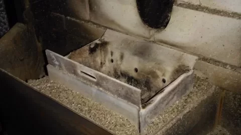

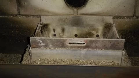

Here it be.

Here it be.

Here it be.

We are about the same ... a couple little storms, some ice but other than that, we are still snow free. I'll take it down here but I'm hoping for some up in Maine. We do a lot of snowmobiling up there and if there is no snow, not many people make the trip.
I see your burn pot config. You can always try something like laying a piece of bar stock across the front and see if your glass stays cleaner longer. Heres a nice trick for cleaning your glass since these always need cleaned. Pick up a small 6 inch or so squeegee and when you clean the glass, just mist it with some windex, make a couple quick passes and your done with no streaks. Give it a shot.
