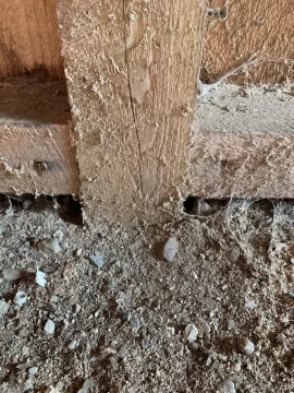

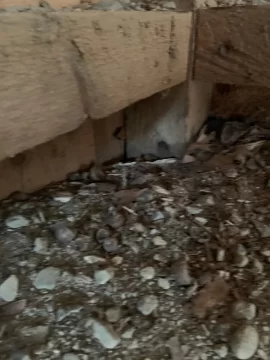

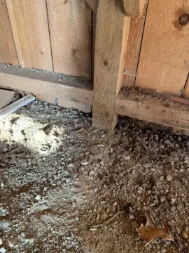

Provide a picture of the pole barn interior posts and how many there are.
The barn is 25x25 and has 4 corner posts and a post in the middle of each wall. So 8 posts.

I would probably use a small backhoe to excavate the posts from inside the building one at a time. Cut posts a couple of inches below bottom plate, install sonotubes (depth for your area), imbed metal post bracket between post and cement. Be prepared to temporarily support wall/ ceiling with appropriate structure.
I would also remove 4" of floor material to bring new concrete floor up to the bottom of the bottom plate.
Its a lot of labor, not much in materials. Concrete floor will be the most $.

I have a finished pole barn. It’s like a house. Pour concrete right against the posts. If untreated you can wrap with tar paper before the pour.
You won’t be replacing that post without cutting the concrete. No big deal, rent a saw, cut out enough floor to do your work IF it’s ever needed.
It's interesting that 25 year old posts are still solid. Can't tell species from pic. If it was me, I would do the this. Remove and level crushed stone to get 6" under the bottom plate and 4" across the floor. Add roughsawn 12" 2x4 to the sides of each post on top of the purlin to transfer post load to purlin. Place concrete floor level with bottom plate and work in under with a vibrator.
This will create a shallow footer under the wall to transfer loads from post to plate and footer if the posts ever fail.
To address the walls place unfaced batt insulation in the wall cavity, staple black plastic floor to ceiling and cover with rough sawn 1x6. Similar with the ceiling, but you probably will need to add nailers for the roughsawn.
Rodent control is easier if there is nothing in the building for them to eat. We use cats in the barn. There are effective poisons also.

That bottom plate appears to be toe nailed only into the posts, transferring the load to that will give limited support if settling occurs. If he bolts a new plate across the interior and bolts the bottom plate and the structural posts together, he might accomplish something..
Yes plates could work also, but if you screw 2x4's to the side of the post on top of the plate you get enough load transfer for this small building.
