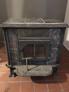

[Hearth.com] Who recognizes this? I don't.
for 50 even if you don't use it you could turn around and sell it for 4 or 500 dollars. the stove is nice but on wood it only gets 4 hours on a load give or take a hour. i don't have a coal hopper for it so don't know about that part.
I can say for every square inch it is the heaviest stove I've ever moved.
Bi-metallic operated thermostat on the back works very well too.

Are they any good? Seller has a moving sale and is asking $50.
Ya they work well.Put a pipe damper in and you'll get longer burn times.Make sure that the inside is not burn out.If so you can order parts from Hearthstone.When I had mine I didn't have the coal burning kit so I put in some fireplace grates over the hole at the bottom of the stove and burned coal.The coal is the way to go.You'll get long burn times and plenty of heat.The coal will after long use eat up the inside of the stove but it'll be worth it.I sold mine for several hundred dollars after the coal ate up the baffle.The stove gave me 10 good years of heat and I bought it used from my cousin who never burned coal in it.The stove should have a plate that covers the hole at the bottom of the stove to be used when your burning just wood.Remove the plate and put in grates for coal.Also under the bottom of the stove may be air holes.Plug some or all of them with foil so the wood will burn slower.Keep us posted.Take care.Oh ya, for fifty bucks you can't go wrong.

Check the insides too. This stove had a single steel secondary tube down low. If that tube ruptures it causes a billow of flames in the center of the stove which can warp and destroy the baffle. The tube is easy to replace and probably should be as a preventative measure even if it looks ok. You can use stainless tubing or even a 1/2" black iron pipe IIRC.
Check out this thread for an awesome documented rebuild on this stove
https://www.hearth.com/talk/threads/1985-hearthstone-ii.143670/

Stove is cracked.

thanks rich. jan all the plates inside can be bought for less than the stove is worth. i had a welding shop make my baffle (the top curved one) for 30 dollars less then the original and no shipping. so if your interested in the stove it's not hard to do. and i have the manual..
