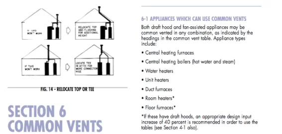

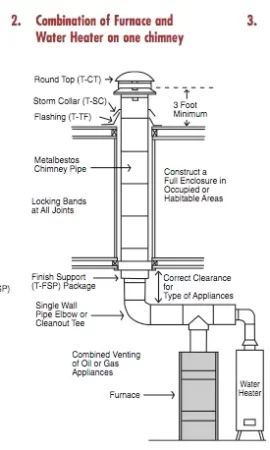

keyman512us said:
Do you mean 6 gas furnaces all sharing the same flue....or could one put 4 gas burners and two oil burners all into the same flue???
From what I've heard you can't "mix fuel types".
This answers the multiple gas part of your question.......
  • [Hearth.com] Why can't they share a chimmney?
Thats all fine but it doesnt deal with a wood burner
