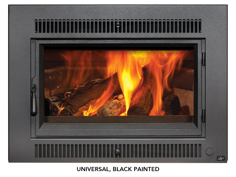

Hi there, new member question. I saw parts of this question come up in other threats, but I couldn't find responses - advance apologies if this has already been asked/answered.
Short version:
1) Why did Lopi stop making the wood hybrid inserts given that the new Lopi non-cat wood inserts are not eligible for the 26% 2021 tax credit? Is there a mechanical or other issue I should know about before buying a (now discontinued) Lopi Hybrid-Fyre Wood Insert?
2) Will a Lopi Large Flush Hybrid-Fyre Wood Insert burn too hot for my small home?
Details:
I have a 850sq ft., one-story house and am looking for a wood burning insert for my existing fireplace. Supplemental heat source in the Pacific NW. My 1950's house is insulated but not tightly - it's generally pretty cold/drafty. 8' ceilings. Fireplace is on a western wall in the main open floor plan living area, which is a space about 600 sq. ft.
I am interested in the Lopis given that they are made near me, are independently owned, seem to be high quality, and get good reviews in these forums. But, I'm confused about the current vs. cat models. I have two priorities: 1) getting a model that is eligible for the 2021-2023 tax credit and 2) getting the right size/model for my home.
I am very confused about why Lopi stopped making the hybrid inserts given that the new Lopi non-cat inserts are not eligible for the 26% tax credit. I just talked to a dealer who really likes the Lopi Hybrids - he bought more when he found out they were going to be discontinued.
The dealer is pitching me a Lopi Large Flush Hybrid-Fyre Wood Insert that he has on hand. It would fit in my fireplace.
First question: after the tax credit is applied, it would actually end up being quite a bit less expensive for me to buy the Lopi Large Flush Hybrid-Fyre Wood Insert that he has on hand, vs. the Lopi Medium NexGen-Fyre Insert. Around $1000 cheaper. The dealer told me that they've been selling the Hybrids for 6 years and haven't had to replace any customer cats. He said Lopi stopped making the cat versions bc they could offer the non-cat inserts for $300 less. (But given that the new models aren't tax-credit eligible, they are actually more expensive than the hybrids).
So what I am missing - did they stop making the cat version bc of a mechanical issue? Or other problems I should be aware of? I know about needing to burn dry quality wood, vacuum the cat seasonally, avoiding damage to the cat, potentially need to replace the cat at a $400 cost, etc. I'm just not understanding why they changed to a new model that isn't tax-credit eligible. He also told me that there was no scenario in which I would need to replace the cat and they wouldn't have the part - does that sound right?
Second question: will the Lopi Large Flush Hybrid-Fyre Wood Insert be too big for my little house? Can I really burn it cooler, or will I just end up overheating the house? When I told the dealer that I was concerned about it being too large for my space, he showed me a BTU chart demonstrating that the Large Flush Hybrid-Fyre actually burns cooler (starting BTU's around 10K) than the current Medium NexGen-Fyre Insert (low BTU's around 14k). Does this align with people's experience?
Advance thanks for your help with this!

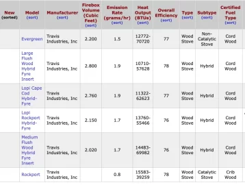

BTEC members lobbied for the arbitrary 75% threshold which is biased toward pellet stoves and some cat stoves. Changing it to say 73% would include a lot more of 2020 compliant wood stoves. As is, the credit helps a few companies while hurting the sales of a lot more that are still absorbing the costs of the 2020 EPA requirements.
That said, there are several Lopi hybrids that qualify and their non-cat Evergreen also.

When I looked at that list earlier I could only find a total of four qualifying inserts - am I missing any?
  • Lopi Medium Flush Wood Hybrid Fyre Insert
  • Lopi Large Flush Wood Hybrid Fyre Insert
  • Regency Cascades i1500 Small Hybrid
  • Regency Cascades i2500 Medium Hybrid Insert
begreen
Mooderator
Staff member
Nov 18, 2005
99,748
South Puget Sound, WA
The Medium Flush Hybrid Insert looks like it would work if it fits the fireplace. Not sure why the dealer is blowing smoke. The hybrids have a cat. That's why they are called hybrids. The Lopi large hybrid would be seriously overkill. If you want a Medium Flush, call around to other dealers in the area.

The dealer told me that the Lopi hybrids have been discontinued and can't be ordered from the company. The hybrid models are no longer on the Lopi website. The statement was: "I am very confused about why Lopi stopped making the hybrid inserts given that the new Lopi non-cat inserts are not eligible for the 26% tax credit." Just wanted to make sure I'm understanding why the models eligible for the 2021 tax credit have been discontinued. Your response about the lobbying answered that question, thanks.

Note: I believe that the information on the Lopi website may be inaccurate. See this;
It shows a BTU of 17,900 to 66,736 BTU’s Per Hour
Their website shows this:
EPA Tested BTUs : 10,710 to 57,628 (CORD WOOD)
Logic would tend to suggest that they simply made a typo on their website.
(Edit - I found some new data: )
There are also the EPA measurements,
10710- 57628 (for the Hybrid fire) https://cfpub.epa.gov/oarweb/woodstove/index.cfm?fuseaction=app.appliancerecord&appliancesID=4762
17900-66736 (for the Nexgen fire): https://cfpub.epa.gov/oarweb/woodstove/index.cfm?fuseaction=app.appliancerecord&appliancesID=4935
So, it's a bit confusing. Is it possible that the larger stove hybrid stove has a smaller heat output? I am struggling with this same decision for my home.

The difference in numbers is due to the difference in testing methods. The epa test is done by loading to a set density. The manufacturers testing is done by filling the firebox as full as they can

Yes, the dealer showed me a chart with these same numbers, and he was advocating that I get a Large Hybrid Insert because 1) they had them in stock and 2) they have the capacity to "burn cooler" than the Medium. I called the manufacturer's service line and they said the same thing - that I should think of BTU's as "zero-to -high number," and the level of air control offered on these models means the fire can be kept very low. They said the numbers are not a typo.
However, I asked enough questions about it that my dealer called a supervisor at the manufacturer. The supervisor said that people with smaller spaces end up unhappy with the Large because it's hard to get a draft while always keeping the fire so small and low.
And, the supervisor found that they had two Medium Hybrids left at their factory and he sent one to me! So, I've ended up purchasing the (now discontinued) Medium Hybrid - it's being installed this week.

@OregonStrong Thanks for starting this thread!! I'm researching inserts and have been thoroughly confused by what Travis Industries is doing. I especially don't understand which manufacturer (Lopi vs Fireplace Xtrordinair) makes which model - their websites are so contradictory I'm tempted to forgo them just to avoid the headache.
For example, does anyone know if the Large Flush Wood Hybrid-Fyre, the one that is listed as 78% efficient on the EPA website and would therefor qualify for the tax credit, is made by Lopi or Fireplace Xtrordinair? And I'm guessing it's no longer in production, based on OregonStrong's experience?

The 75% was not arbitrary. The 75% efficiency was arrived at by permitting 40% or more of solid fuel products to qualify for the tax credit. On average, other product categories that qualify for consumers tax credits (think doors and windows or appliances) only 10% usually qualify. The 75% threshold is based upon multiple factors, including the IRS looking at how much the tax credit will cost.
BKVP
Of the 40% of qualifying products, aren't most pellet stoves? Why 75% instead of 74 or 73% which would have included many more wood stoves when the goal is to increase the number of clean-burning heaters?
