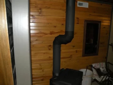

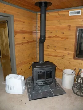

Well, yesterday afternoon I received a phone call from the installers for my wood stove that they were on their way to my house to deliver my new stove. I assumed they were doing just that...delivering the stove but come to find out they were there to install it as well. So, three hours later and I have a working wood stove in my house! Everything went very smoothly other than they ended up putting 2 90degree bends in my pipe. It was suppose to be a straight up chimney install but due to ceiling joists they had to get around it. So, they installed a bend that is not a full 90 degree but still a pretty good bend in the pipe. They assured me that this would not harm the draft etc. Is that true?

Bob. Might those bends become a big problem for cleaning the chimney? Sounds like a nightmare in the making.

The bend is actually right above the stove so I should, in theory at least, be able to remove the screw from the bend and simply turn it out of the way. Once out of the way, it is a straight shot right up the chimney. I am hoping it will be that simple at least! Worst case scenario, we have a local chimney sweep that charges $75 to come due it.

why didn't they do two 45s instead of two 90s?
Good point. I prefer to offset with a pair of 30 degree elbows. Chimney brushes can navigate 30's better and the higher angle is less likely to hold loose creosote that peels and falls.

I have attached the pictures of our setup. I plan on building a full brick hearth this summer but for now the hearth pad suffices. If the remainder of my chimney is a straight vertical run will this bend affect my stove's performance?

Should draft fine... offset could definitely be done with two 30's or 45's... varying length of pipe between of course.

Looks great! Make sure that humidifier and plastic bucket are not there when the stove is running...
