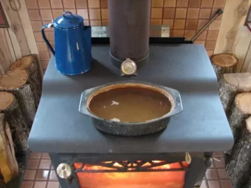

  • [Hearth.com] Why doesn't the water boil?
One is covered, the other is not...holds heat in a bit, enough to make the difference.
