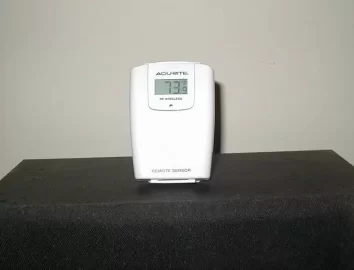

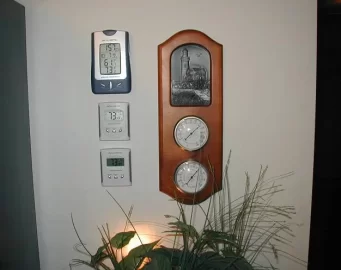

Thermometers i believe are better served around your home and one out side. When you can see at a glance when the different rooms in your home tempture is and also what the out side temp is and how these temperatures are changing it lets you better to control the stove.
Pictured is the base units of my houses thermometers showing all the different temperatures of different rooms / front - back / up stairs - down stairs / outside temp .
Also showing the wireless thermometer X 6 units.

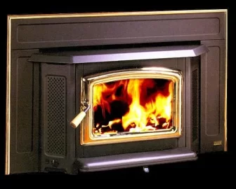

I know about thermometer placement on a stove, but what would you recommend for an insert? I know about the center-vs-side argument - that center will be sensitive to the secondary burn - but there still seem to be a number of different opinions out there. My Summit (and I think most other inserts) don't leave you with a whole lot of options (see below). Is it possible to get a remote flue sensor to read pipe temperature like on a stove?

PacificGuy, I have the same problem with my insert. The Osburn bay window gives me really no place to put the thermometer on the front. I currently have it sitting on top of the 'cook top', in the center. Since this area is separated from the fire box by an air gap (where the blower circulates) I'm sure that the temp is not an accurate reading of what the top actually is running at. It does give me a benchmark though.
If i were you i would just put it above your door off to the side and go from there .
When the front ( in the middle) thermometer reading showed 700° on mine the top was around 550° if that helps you out.
The front reading changes faster and gets hotter then does the top temp on the monsters.
I assume your looking for max heat with out overfiring per the thermometer ?
