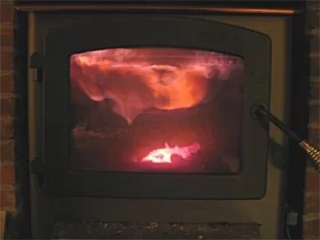

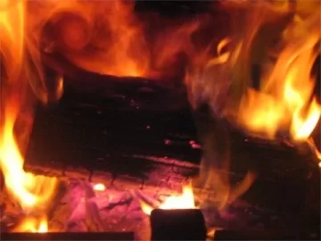

A big part of it is that fixed secondary air is introduced at the top of the firebox no matter what the primary air adjustment setting is. And that primary can't be closed down all the way either. If you leave the primary wide open with small loads the unburned gases exit the firebox too fast for them to be combined with the secondary air and burned. The primary air isn't pre-heated and actually cools the firebox. The secondary air is pre-heated and ready to burn the second it come out of the burn tubes/baffle manifold or whatever your stove uses. You in essence just make your EPA woodstove into a Chimea by burning with small loads and primary wide open all the time.
You start out like the one on the right and damper down to like like the pic on the left. Makes for quite a show for us former old style stove burners.
