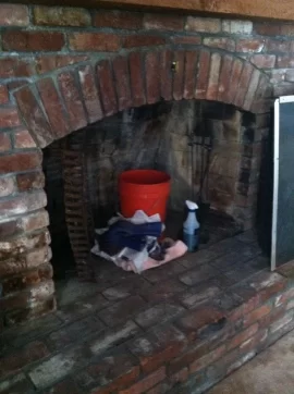

Hello,
I am looking for a medium sized fireplace inserted stove. I have found many models that meet my heating requirements. However, I have only found one with trim wide enough to cover my fireplace opening (Jotul 450 Kennebec). It is an arched opening, 47" wide and 33" tall at highest point of the arch. Does anyone know of an insert with trim big enough to cover this?
Thank you
(edit: picture added, please ignore the cleaning supplies in the fireplace)

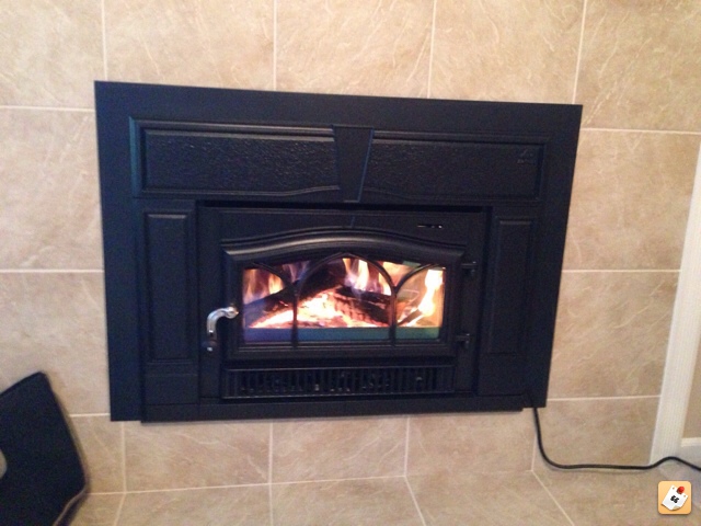

When I had my Jotul 350 installed they had to fabricate a larger surround. It was originally designed off the Jotul extended surround. My fireplace was very wide, but not tall so no surrounds would fit my width.

That is very nice insert and trim. I should add that the Jotul 450 is pretty much out of my price range. Otherwise I would just go with it.
+1 might need to have some custom fabrication to cover the space. BTW, I like the arched brickwork.

Check the Regency I2400M.. It has an oversize faceplate that measures 48" w x 33" tall. That faceplate can be modified to fit your arched opening. I did it with my sister's install. Made a cardboard template & laid out the surround. Cut it with a jigsaw & benched it to fit.
Depending on if you want to get fancy with the surround or not you could have a local metal shop fabricate a surround to fit within your arch so you can keep that look.
I really like the arch too. I'm hoping to keep this project around $3,500 so custom metal work is probably out of the question. I am a woodworker so I was wondering if I could build wood trim to cover any gaps between the metal insert trim and the fireplace opening. This would allow me to maintain the arched look. I don't know enough about the clearance requirements yet though. Any thoughts on this approach?

I kind of agree with Mellow too, you might enjoy the best of both worlds with a free standing stove and the opening of the fireplace. Your fireplace is too nice looking to cover up. There are stoves that will fit that space and the flue will come out of the back of the stove and up. A consideration :)
I am trying to heat a 1,600 square foot two story house, crawlspace foundation. Fireplace is on the first floor, which is about 1,000 square feet. The fireplace opening is 48"x33" and is 26" deep at the base, in the center. The firebox tapers in on all 3 sides. I will get those dimensions this evening.
I seriously doubt you can put any combustible wood that close to your insert. The area you are talking about is probably the hottest spot surrounding and insert. I agree with several of the other posters regarding how nice free standing stoves look in front of those arched fireplace opening. As you can see in my avatar I have a Jotul F 600 sitting in front of (and partially inside) my fireplace.
