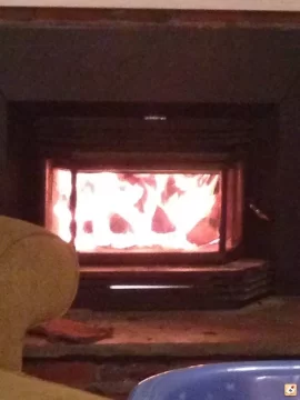

We purchased osburn 2200. In October. We could get house to 85 but it was warm in early October. We were having 70 degree days. 50 degree nights. Well now November is here and it's still mild temp. 40 degree days 30 nights. The house just won't get over 68. We were told by sales person that he predicts 70 in the winter. I can't see that happening. I wish I was on this forum before I bought! It is an insert. Wood is all under 20 percent. I've been following burn Guide lines. Experimenting with different burns. I just don't know , I'm thinking it's undersized. House is 2600 sq , not to worry about upstairs I don't want it to be hot hot up there but would like it to be warm. What would you guys do. I spent pretty good money on this and I can't see it being a super performer come cold winter days
4 am came down 62 degrees. It's been running for 3.5 hours and house is now 64. Is this typical results ?

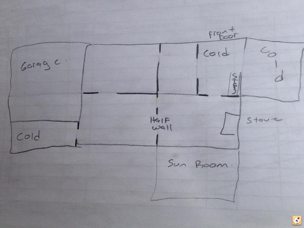

Need more info. Sounds like your stove is downstairs? How is it heating the floor it is on? You are expecting it to be warm upstairs on the level above the stove? Are your floors insulated? What is the layout? Its still cold on the main floor the stove is on?
Stove is in family room. House is older 1960. The insert room gets warm. Set up is normal.
Not overally concerned with upstairs. Ceiling is not insulated Going to upstairs . I also hung tissue in all opening and air seems to be moving.

Possible worst drawing ever. lol
On warmer days it does the trick. I think I'm just more suprised that it can't heat a cold house. Honestly my old open fire place got that room warm and comfy. Used more wood but did not cost as much to install lol ( it was there when I bought home ) haha
your not going to get it up to 70 with a 2600 sq ft house and 2.2 firebox. Its only rated for 2000 sq ft in a perfect setup. In reality probably will heat 1600 sq ft
Yup that's what I am figuring now. The guy came out to house and all. That's what pisses me off

I have a somewhat similar set up to the one you show in your drawing at 2450 ft2. My thermostat is located in the room you show your stairs (I'm a center hall colonial). I have heat on and set at 69* the same as if I didn't have the insert. Last night at 10:00 when I went to grab wood it was 75-80* in the family room (insert room) according to the IR, 71* on the thermostat, (although my IR read the wall at 75*) and 26* outside. As I was walking back to the house I heard my neighbor's heat pump kick on. Mine hadn't run all night. I smiled. My attitude is to get as much free heat out of my insert as possible. In exchange for that free heat I'm willing to expend effort but not sacrifice comfort. (My wife won't allow it).
