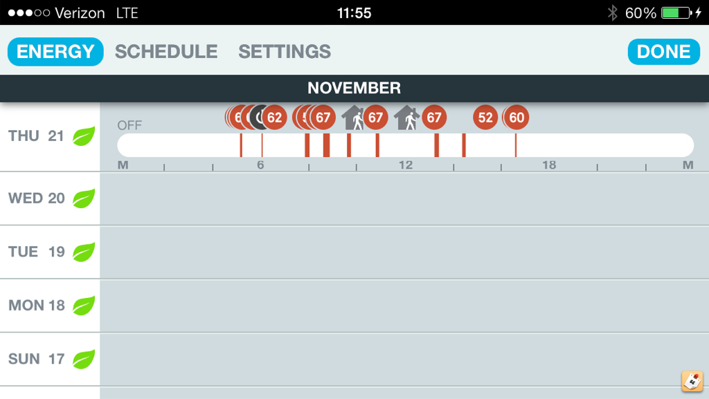

Actually looking at pic I guess I set it to 60 around 5 did not come on yet. House is at 74 right now so it seems to hold some heat. Like I said though it's 50 out today not very cold.
The stove does do better maintaining than raising , but it did raise from 68 to 71 (71) when I got out of bed this morning

I just checked my Nest for the first time, I have 2 on opposite sides of the common area. I only setup one on my smartphone. That Nest is set to 64 and reports "NO USAGE" for the last 10 days except for 1 30 min period on 11/15 at 6AM, temp was 26.

Nest is awesome. I love being able to see a moths worth of data. Tells you every time heat I'd on. Not to mention about ten other awesome features ! I recommend highly
