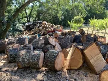

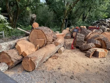

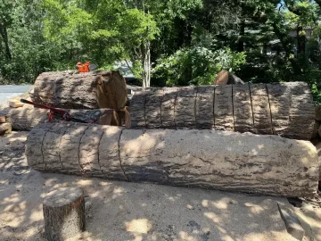

Also I love my 390 and it performs as you say. I took the "28 inch bar off, replaced with a "20 and works great. Yes I'm keeping the blade razer sharp and flipping the bar ever 1-2 hours of use.
I am about 1/2 through that pile by now (got a day job and other project distracting me from dwelling on completion of that pile).
