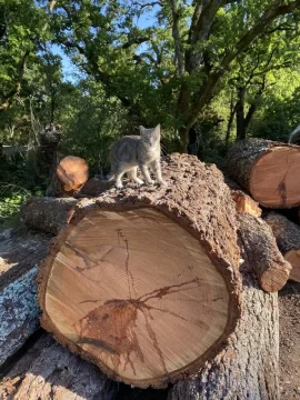

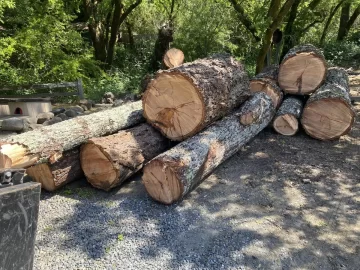

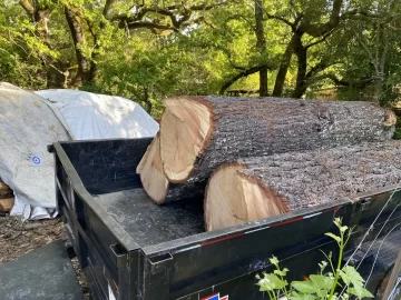

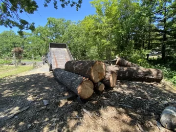

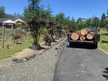

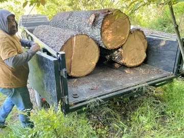

A guy near me was taking down a few large Doug Fir trees and asked me if I wanted the wood. I said "sure". Now that all six trailer dumps have been delivered, I am wondering if I've got enough saw given I only have the ms390 with a 25" blade. Any thoughts?

It's a professional series 65cc saw. Why wouldn't it? I find it weird that you own a pro saw but are clueless about what it can do. I'd have no problem cutting this with my 261 with 18" bar

You can easily cut 40”. Keep your chain sharp. Try and keep the buck lined up. Don’t get pinched.

Cut some 40"+ red oaks with a 390, 25" bar. Buried full, let 'er rip.

I think the bigger challenge is how to handle/position the logs safely for cutting unless you have a grapple or something.

Not really. Start from the top and roll off the chunks as you cut. I really don’t see why this is tricky. It looks normal to me. Am I missing something?
pic 7659 looks like things need to be moved before I risk breaking a leg when it rolls with me on top.
